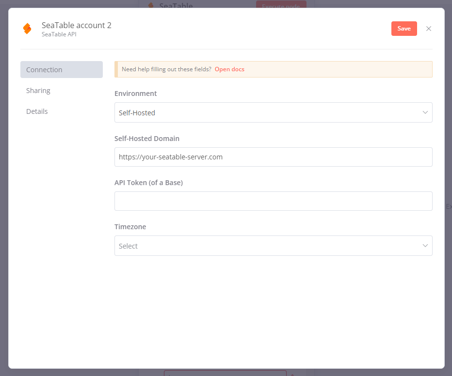

This is not correct. n8n also supports self-hosted SeaTable Servers.
This is a screenshot from n8n Cloud which I use:

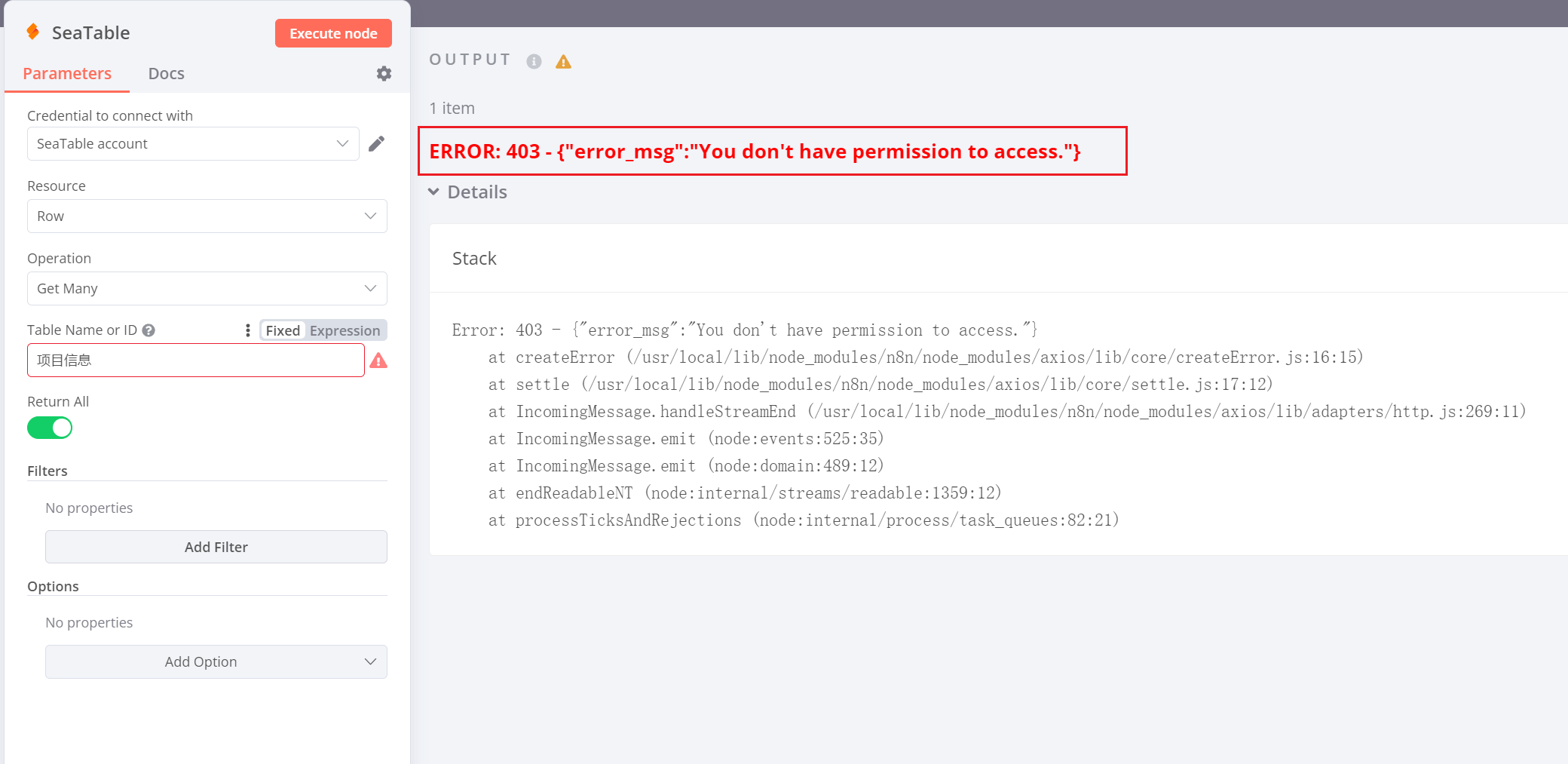

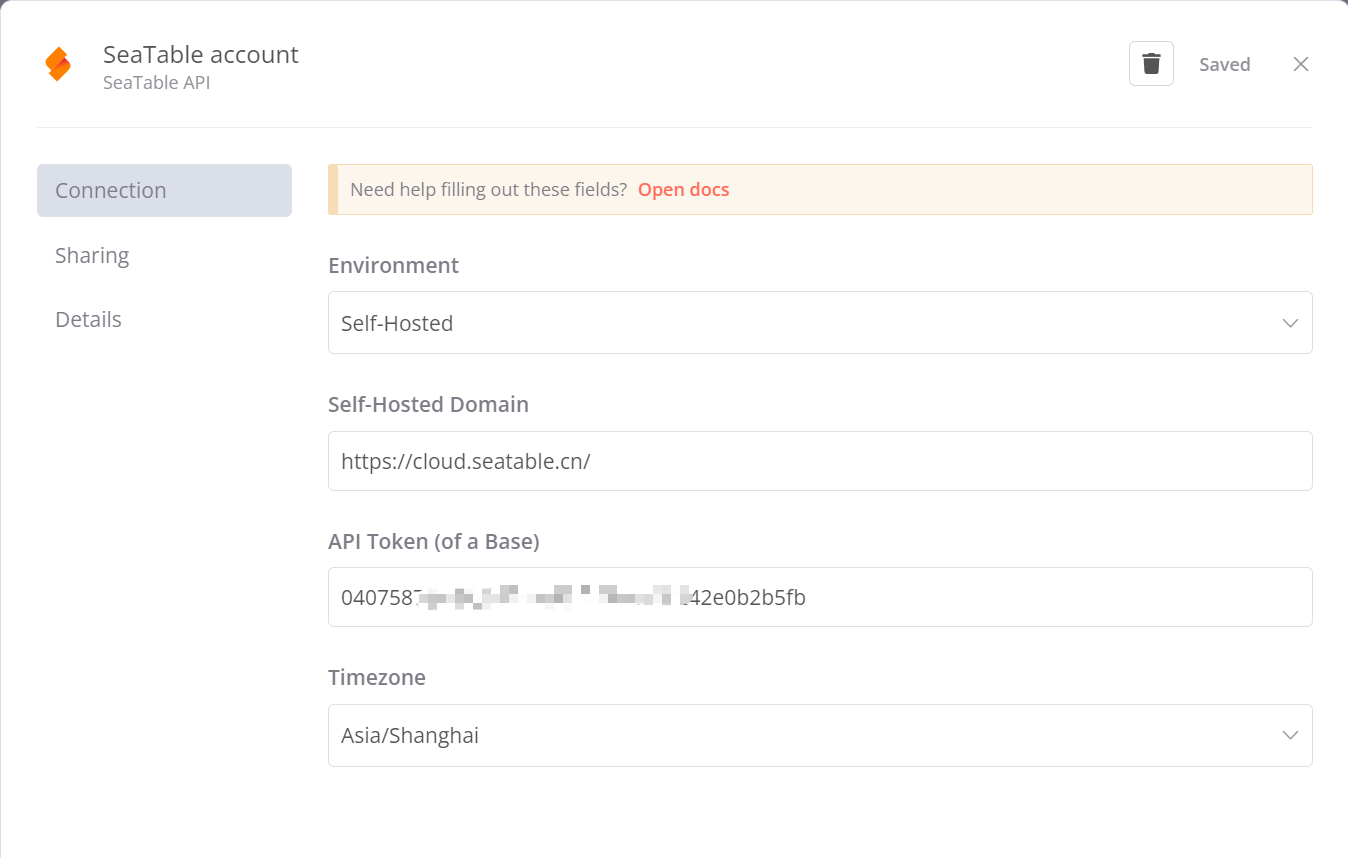

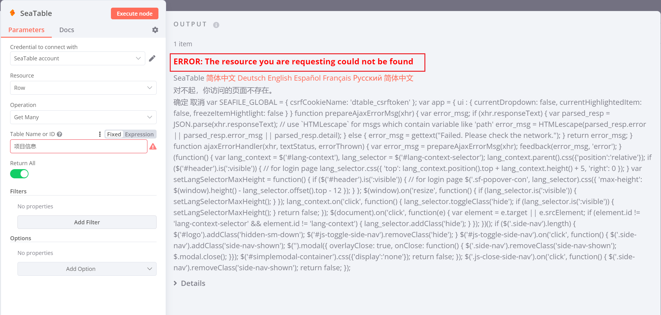

之前有尝试过,但是Self-Hosted Domain怎么填都会报错,比如:https://cloud.seatable.cn。
I tried with two self-hosted systems. It worked.

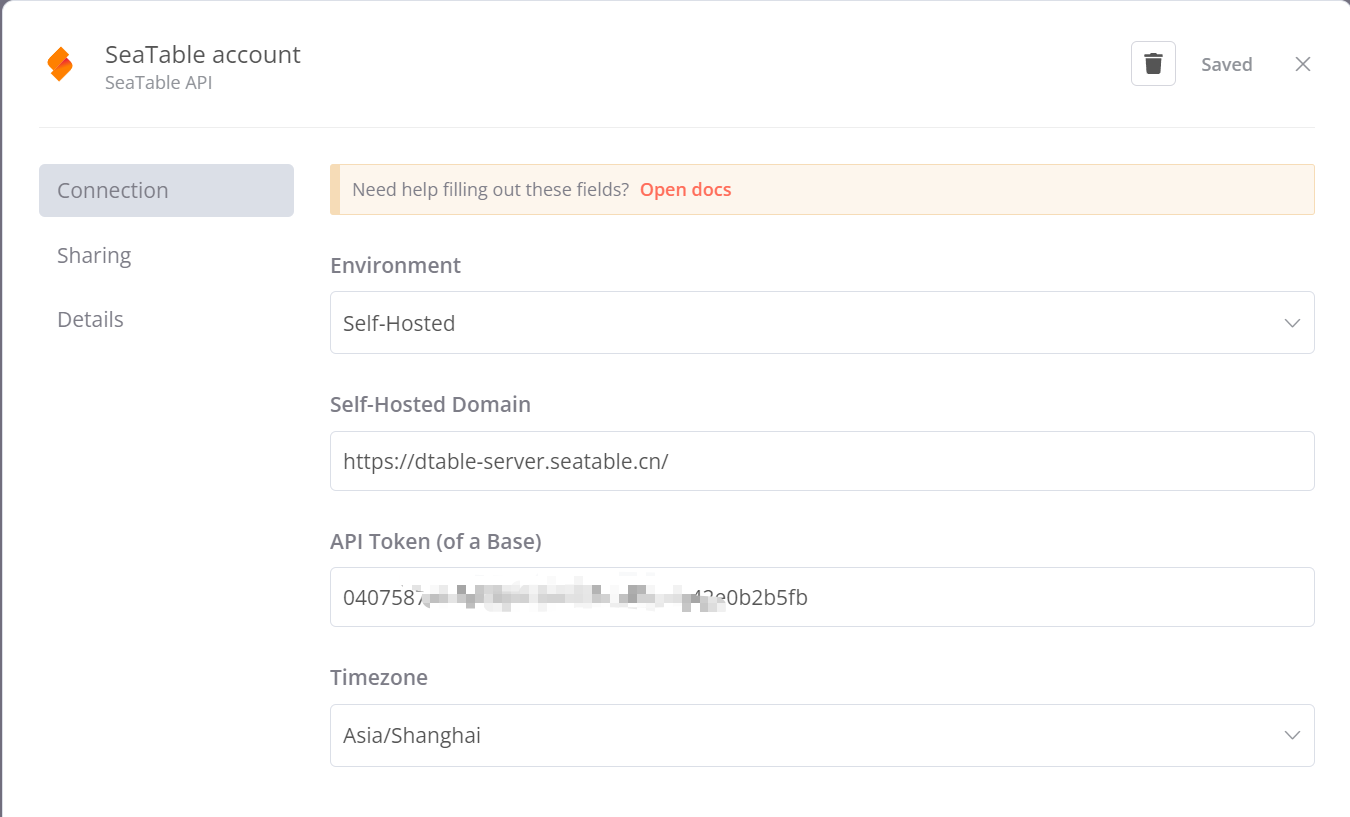

https://dtable-server.seatable.cn/ is no valid domain. This cannot work. Open the URL in your browser. Then you see the error message that n8n returns as well: “You don’t have permission to access.”
https://cloud.seatable.cn is a valid host address. So it should work.

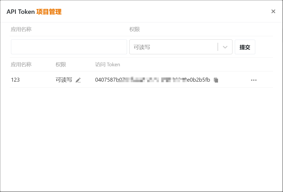

I created the api token here.
Sure, but on which system?
